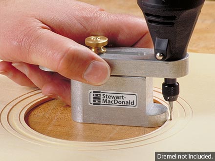

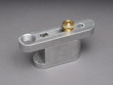

Posts: 409
Something like this might work. About $42 from StewMac. Doesn't look too difficult to make.

PostPosted: Fri Apr 21, 2006 1:47 pm
I've got one of those, but I haven't used it yet.

Only negative I see with that tools is that it is counting on a perfectly even and square surface to register from. If there is a lump or dip in the soundhole then you will have the same line conveyed to the rosette. The method I described will tend to mask these small irregularities.
